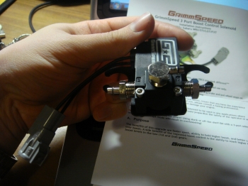

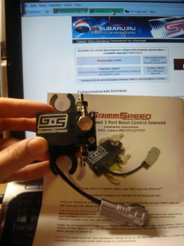

Ура.... приехала небольшая партия ништяков (Новогодний подарок для моей STI и для меня).
Первое что приехало - это новый быстрый соленоид управления наддувом Grimmspeed (Крупнее фотки тут)
http://www.24subaru.ru/files/pre_154...e0360b558c.JPG
http://www.24subaru.ru/files/pre_507...e0383ce9a1.JPG
Купил с ebay. Около 110$ + доставка до России.
Зачем оно нужно:
Grimmspeed 3-port Electronic Boost Control Solenoid (Subaru WRX / STi)
Main FeaturesЦитата:
GrimmSpeed introduces the most complete and easy to use 3-Port Electronic Boost Solenoid available on the market. Our aftermarket boost controller allows you to raise the OEM boost levels in a quick and efficient manner. If you try to raise the boost on the weak OEM boost solenoid it will start to become unpredictable and unable to maintain proper and safe boost levels. Using our solenoid you are able to spool your Turbo quicker and maintain a rock solid boost level. We have made our solenoid to withstand 120psi, way more than any Subaru will see.
Revolutionizing the Subaru boost solenoid market, we have created model specific install brackets that allow you to directly fit our Boost Solenoid into your Subaru for a factory fit. No more Zip-tying! We give you the factory fitment you have been waiting for.
Staying with the OEM fitment theme, our Boost Solenoid uses a Subaru style wiring harness so you can simply unplug your OEM solenoid and plug ours in. No more cutting the oem wiring and crimping wires together!
Also new to the Subaru boost solenoid market, we have used ultra low-profile hose fittings to keep the unit as small and clean as possible. The hose fittings are nickel plated brass so you don't have to worry about them snapping off like the plastic hose fittings!
Additional FeaturesЦитата:
- Direct plug and play into oem wiring.
- MAC Valve has completely custom made the valve for us(only MAC valve on the market to be custom made for automotive tuning use).
- Users can use AN fittings with the solenoid.
- Mounting bracket so its a direct bolt on into factory location.
- Low-profile brass hose fittings(small in size so its compact, no chance of breaking fittings like the plastic ones our competitors use).
- Specifically designed by GrimmSpeed to work safely with the factory Subaru ECU (requires tuning) and to reliably handle the vibrations and temperatures of your engine bay!
PS Мож кому пригодится - мануал по установке во вложенииЦитата:
- The only direct “bolt in” design for all Subaru models. Direct bolt in mounting bracket and hardware included! (specify which model before ordering)
- Includes plug and play harness, no wire splicing required and easy to return to stock.
- Allows you to raise the factory boost levels with adding more response and more control.
- Allows you to get full boost sooner.
- Faster response and greater flow than any other valve out there. (by more than 10%!)
- Nickel plated brass fittings. (unlike the competitors failure prone plastic fittings)

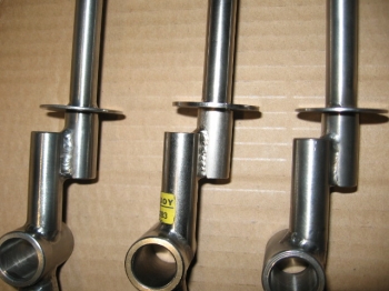

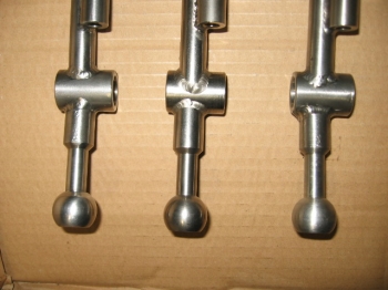

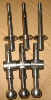

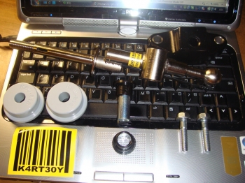

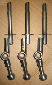

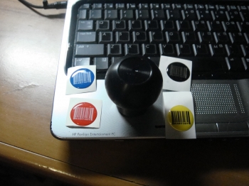

Второй ништяк, который прилетел сегодня - это шортшифтер с усиленными втулками (бушингами) кулисы и крепления КПП от фирмы K4RT3OY (картбой) (Крупные фотки тут)
Металлический наболдашник ручки КПП от Картбой.... приятненький на ощуп...
http://www.24subaru.ru/files/pre_183...e01d2addc3.JPG

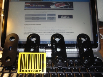

Полный комплект шортшифтер КПП с усиленными бушингами Картбой
http://www.24subaru.ru/files/pre_175...e020cd1373.JPG
http://www.24subaru.ru/files/pre_115...e022fbe55a.JPG
Усиленные бушинги крепления КПП Картбой
http://www.24subaru.ru/files/pre_901...e02e9aa2be.JPG
И еще юмористы Американцы в этой же посылке прислали какую-то адскую конфету... есть ее пока не решаюсь :laugh:
http://www.24subaru.ru/files/pre_108...e032178b80.JPG
Сайт производителя и каталог тут: http://www2.kartboy.com/x4/home.php?cat=257 Однако эти цукеты не отправляют в Россию. Нужно искать посредника, который берет чуть больше (например, http://subimods.com/), но при этом согласны отправлять Worldwide.
Стоимость этого кита около 320$, из которых доставка из штатов съедает около 35$.
Вот ссылка на описание процедуры установки... я правда еще эти мануалы сам не курил :)
Мануал/инструкция по установке короткоходной кулисы Картбой для STI
Kartboy Rear Shifter Bushing
Kartboy STi Shifter Bushing Install

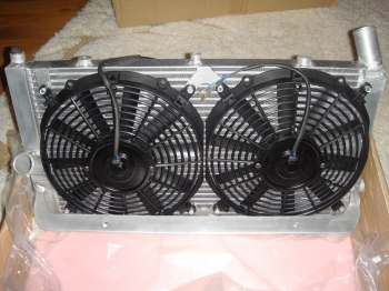

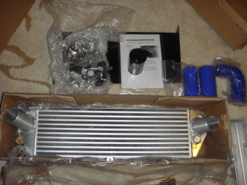

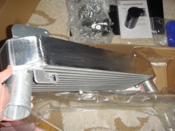

Реплика интеркулер-кита V-mount от POWER Enterprise
Идея тюненха :)
http://www.24subaru.ru/files/1400995...0a2e616f32.jpg

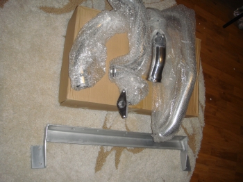

Что в комплекте:
Силикон соединительный, куча всяких хомутов, крепежей, болтов и трубочек
http://www.24subaru.ru/files/pre_729...0a06d5cc66.JPG

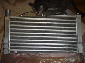

Непосредственно сам интеркулер (цуки на почте левый патрубок чуток согнули... у нас самая деликатная доставка :-D )
http://www.24subaru.ru/files/pre_136...0a0de06d1b.JPG
Пайпы и кронштейн для радиатора
http://www.24subaru.ru/files/pre_185...0a1002e491.JPG

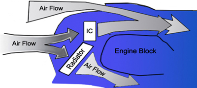

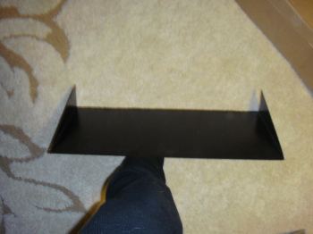

Какая-то направляющая для воздуха... не вкурил пока, мануал не дочитал :)

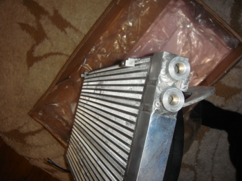

Алюминиевый радиатор со встроеным маслокулером
http://www.24subaru.ru/files/pre_181...0a1bc27f12.JPG
http://www.24subaru.ru/files/pre_428...0a1d049628.JPG
http://www.24subaru.ru/files/pre_119...0a1e2a888a.JPG
Как раз вход и выход маслокулера
http://www.24subaru.ru/files/pre_172...0a1efcfa14.JPG
Если Чё :) Я первый на твою любимую зверушку :dance4:
Жаль конешно что она не лупуглазая и не вагон, но :sexas: уже полный :thumbs_up
зачётный такой набор :) так это не Повер Интерпрайз? реплика сильно дешевле?
может в таком случае ноздрю на капоте перевернуть, чтоб вытягивала горячий воздух? а не загоняла в подкапотное пространство свежий которому некуда собственно деваться, всё равно кулера же там больше не планируется?
Нет конечно... это реплика. Дешевле примерно в 3 раза. Ноздрю вообще убирать планирую. Как придумаю чем заделать дырку :)Цитата:
Сообщение от Связист
дану, Игорь, Субару без ноздри не готична будет выглядеть, тем более твоя, да и охлаждение не помешает, там веть часть воздуха еще и на турбину дует, лучше тогда сделать воздуховод чтобы весь воздух с ноздри охлаждал турбину, +1 см )))Цитата:

Но Славик... тьфу, тоесть Вофчег и Димон... на этом не остановились... Бушинги в полиуретановой мастерской :-|
а мнеееее??? раз уж оптом дело пошло!
забыли товарища... :-(
:-| блин, точно забыли! Прости Ваня, наш далекий друг, мы думали кому бы еще это дело предложить, но про тебя забыли ((( ... хотя может в москве проще так купить, кулиса получилась не на столько бюджетной как мы думали, около 96 убитых енотов, но сделана на совесть из хорошей нержавейки
Ванээээс.... ***, прости, я хоть в заказе и не участвовал, но меня еще Ьэлл спросил... как думаешь, кому еще интересно было бы... я все машины, которые щас остров приезжают в голове перебрал, а твою выпустил...Цитата:
Сообщение от FoReG
Найдем тебе кулису, если надо !
2bell, димыч, когда ставить планируешь ?
ну я наверна только в выходные время найду
а что слесарь Серега в енотах берет??? :)Цитата:
Сообщение от bell
а вообще в эту пятницу подъеду скорее всего на встречу - обсудим что да как
Цитата:
Сообщение от FoReG
2500 рублей без втулки и резинок. Моя (без доставки) 150$ с резинками мелкими.
даже чуть больше, мы материал еще сами покупали, всего затраты 5777 за пару кулис вышлоЦитата:
Сообщение от Figaro
Вано, эти двое разобрали все отмазки, поэтому ты просто меня прости :)Цитата:
Сообщение от FoReG
Вообще на изготовление у слесаря ушло полтора дня, а может и день. Нержавейка в "Вираже" еще есть. Ты только дай команду, мы тебе еще одну закажем :)
